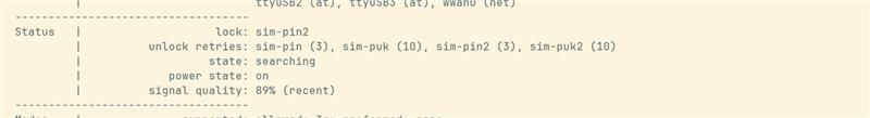

The device connects successfully and operates normally for a variable duration (hours or days). Then, the cellular connection drops.ModemManager immediately tries to re-establish the connection, but these attempts fail.
After the failed reconnection attempts, the modem gets stuck in a “searching” state and cannot find the network again. The only reliable fix is a full power cycle of the host device.
A soft reboot does not fix the issue, and actually causes the state to change to ‘sim-missing’. We have tested removing the SIM and placing it on my cellphone and it worked correctly. Anything we try other than power cycling or modem reset doesn’t help. The software modem reset (mmcli -m <> --reset) works most of the time, but can also cause the modem to enter a disabled → enabling → disabled loop. Manually trying to enable gets me an ‘Invalid transition’ error.
