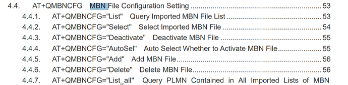

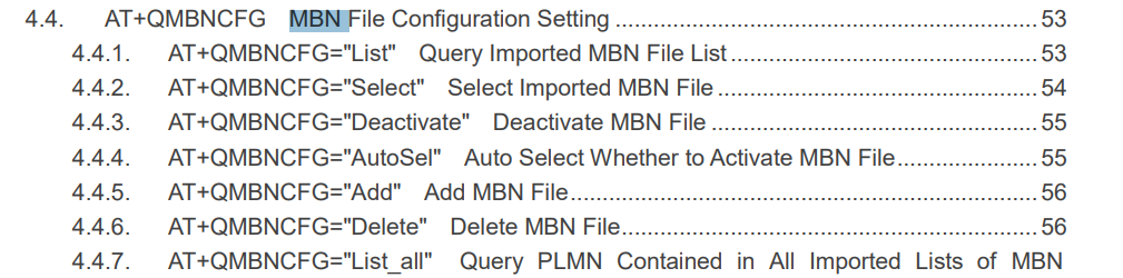

Hi,
This FW is the latest FW version.
AT+QMBNCFG=“List” > you can use this command to check on the listed MBN in the module.
