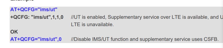

Hi,
Could you please provide the URC response from your terminal.
since your FW is a quite new FW version, this command should be supported.
It should look something like this:
