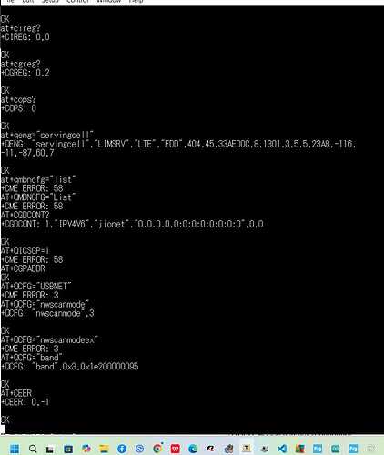

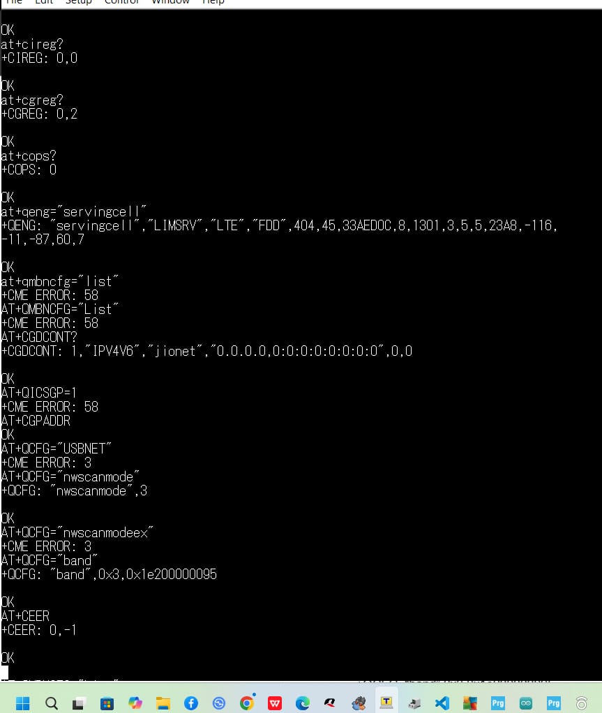

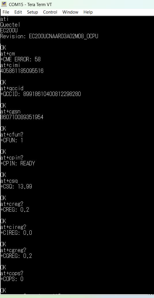

Hi Quectel Team,
I am working with the EC200U-CN module using QuecOpen on our custom-designed PCB. We are facing a network registration issue and would appreciate your support in identifying the root cause.
Issue Description
- The module is unable to register on the network for Jio SIM.
- Airtel SIM sometimes registers successfully, but at the same location it also fails intermittently.
- Surprisingly, in some cases Airtel even registers without an external LTE antenna, while at other times it does not.
- The same Jio and Airtel SIM cards work normally in a mobile phone.
Module Information
Module : EC200U-CN
Firmware : EC200UCNAAR03A02M08_OCPU
Application : QuecOpen
Hardware : Custom PCB
Questions
what will be the issue with the airtel ?
Is there any known compatibility issue with Jio on EC200U-CN firmware EC200UCNAAR03A02M08_OCPU?
Are there any additional AT commands or diagnostic logs that you recommend collecting to identify the root cause?
