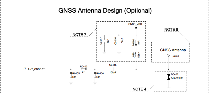

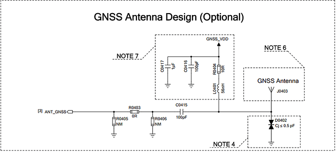

Could you please help me understand why the EC200U module with firmware EC200UCNAAR03A14M08 is not able to get GNSS data even though GNSS has been enabled and configured as above?
Error 516 is usually caused by an abnormality in the GNSS antenna. It is recommended that you recheck the hardware connection.
