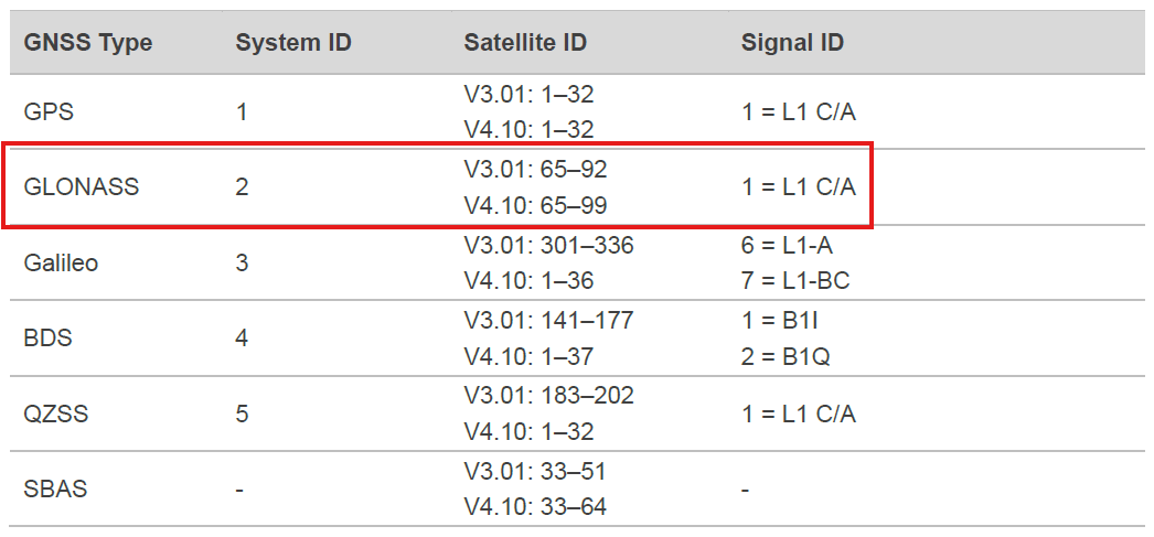

In your log, the Talker ID GN indicates a combination of multiple satellite systems. Both sets of IDs (70, 86, 71 and 82, 83, 91) fall within the standard NMEA range for GLONASS satellites:
  • Standard NMEA numbering for GLONASS is typically 65–92 or 65–99 depending on the specific module family.* The fact that both the $GNGSA and $PSTMSAT IDs are in this range suggests they are all GLONASS satellites.
