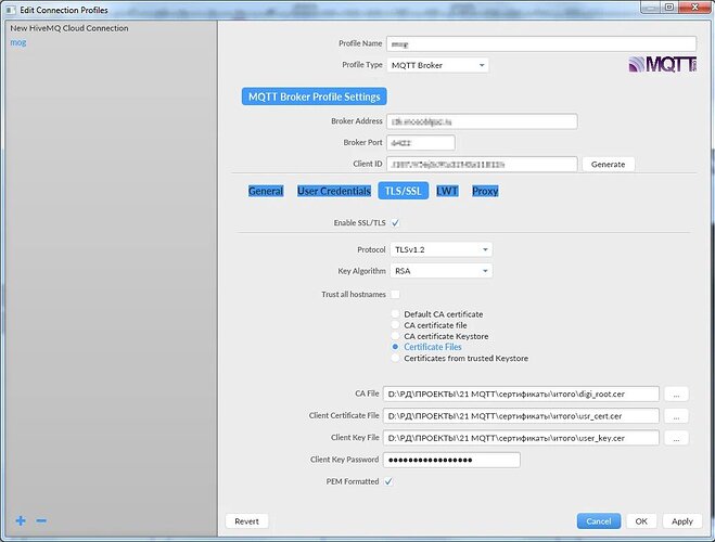

Connecting to server by MQTT and TSL with certificates. Answer for OPEN is +QMTOPEN: 0,-1
Is the SSL method successfully tested by the MQTT.FX tool ?
