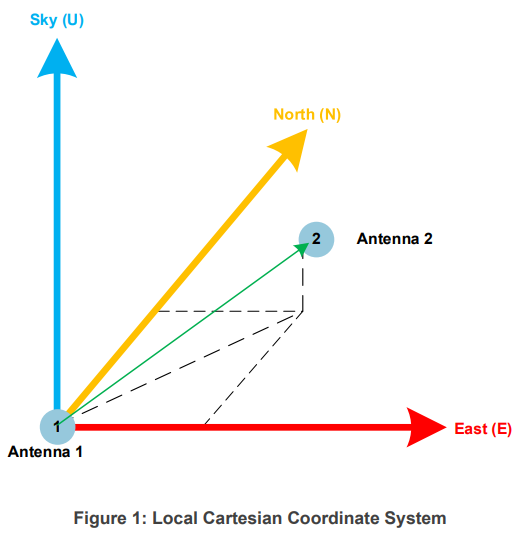

You may confuse with another application case — moving base. This is designed for getting accurate orientation for the carrier. In this case, there are 2 antennas required for one measuring system, The vector from the master antenna to the slave antenna represents the orientation of the vehicle.
This application is commonly used on drones.
