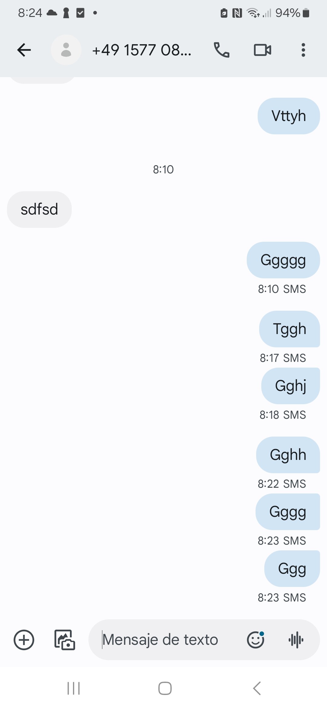

As you can see on the photo attached I received the text messages just after sending it but when I send a sms from the phone and then check with AT+CMGL=“ALL” nothing appear…
I don’t know if I have to do some extra configurations because is a german number or what but this is driving me crazy…
