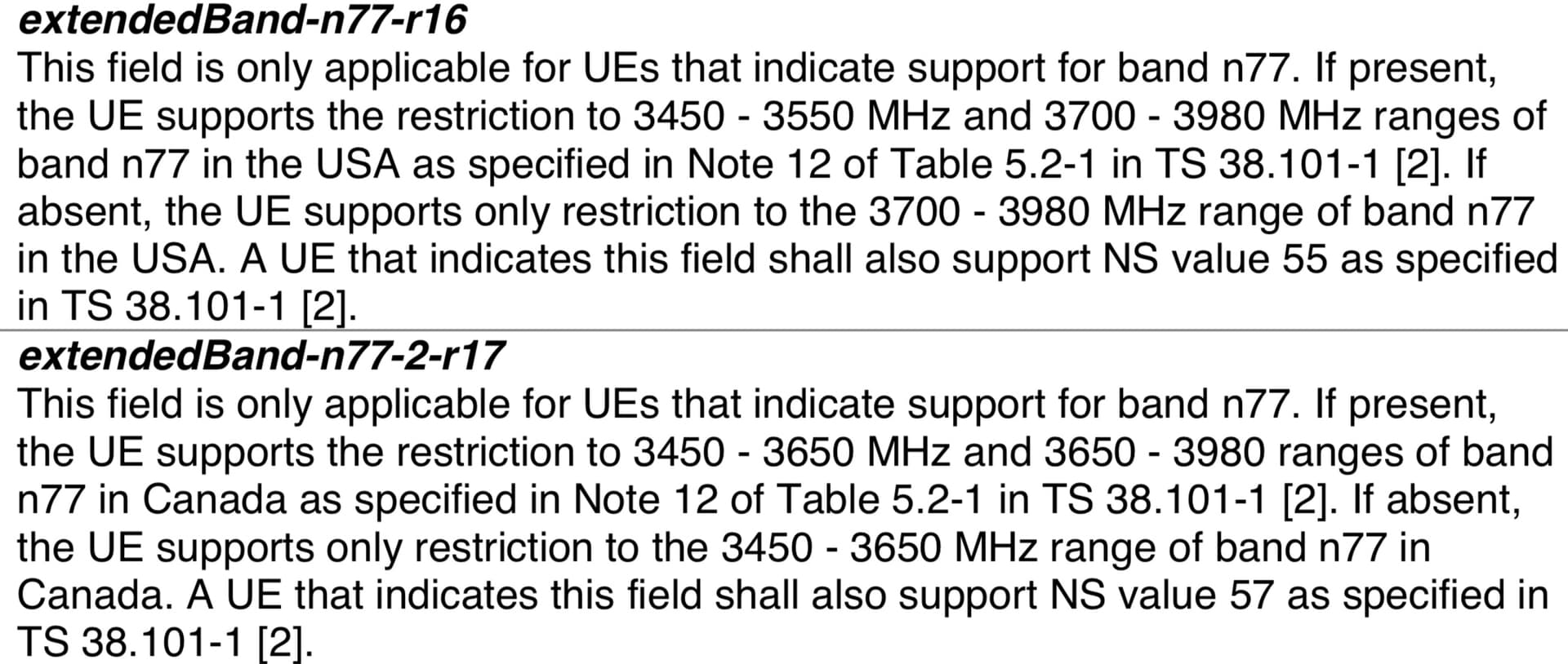

Hi support team. I’m planning on getting RM551E-GL and I would like to know if it supports UE capability extendedBand-n77-2-r17? It’s different from USA’s extendedBand-n77-r16. Without this capability, device won’t be able to access Canadian n77 band.

Please share the frequency of extendedBand-n77-2-r17.
Hi Silvia. The frequency is 3650-3980MHz.
Dear @Archer
Here is operating frequency of n77:
