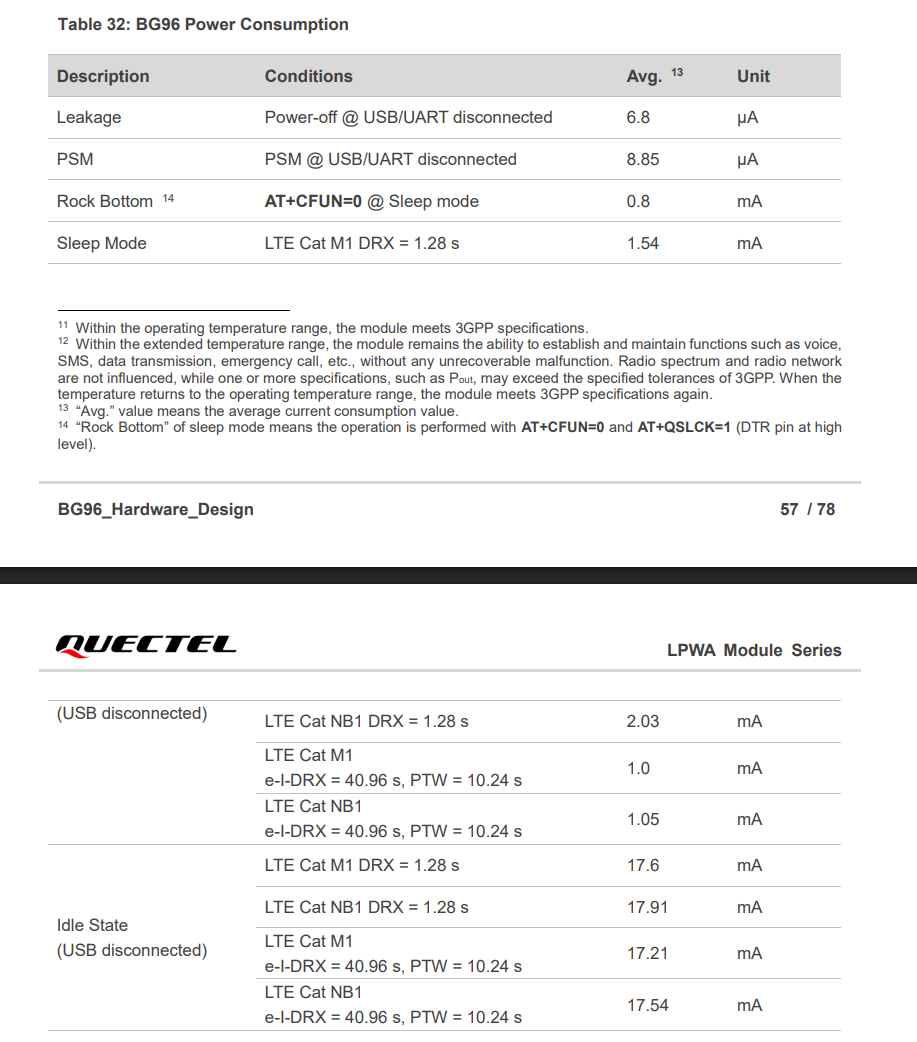

I have read over the document but do not see any reference to GNSS, GPS, or any other positioning/location services.
Is there a document or application note which specifically mentions if it is possible to keep the GNSS functionality active while placing the LTE Cat M1 / Cat NB1 / EGPRS features into an idle or sleep mode? and the expected current draw from table 32
