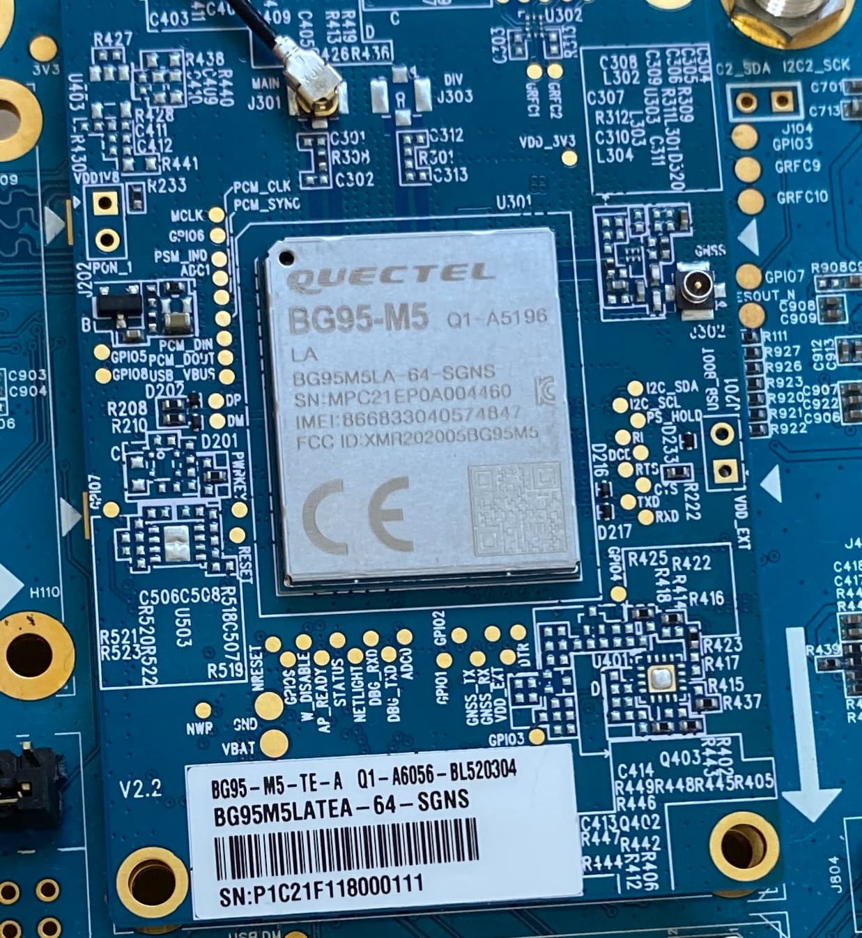

The module itself has a model number of BG95M5LATEA-64-SGNS. The chip on the module is labeled
BG95-M5 Q1 A5196
BG95M5LA-64-SGNS
