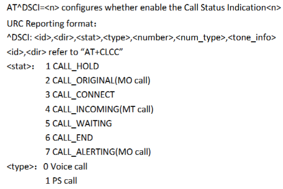

You can try this command AT^DSCI=1

Hi Mikey,
the AT+DSCI command is not implemented at the BG95-M3 module:
BR Martin
The command is AT^DSCI=1, ^ instead of +.
Hi, I also tested it with ^ instead of +. Same result:
BR Martin
Sorry it is my mistake that the command not support on this model. And I will search other commands for you.
