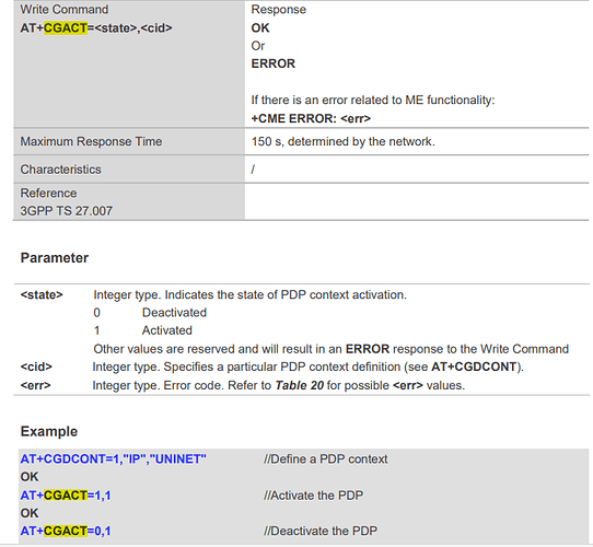

Hi @Philippe_Pinel
CGATT is used to attach PS or detach PS. but your device registered to GSM network. please check with AT+CGACT=1 to activate PDP context.
Hi, i did AT+CGACT=1 but i get error too
Hi @Philippe_Pinel
Please check with below:
