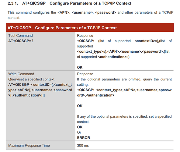

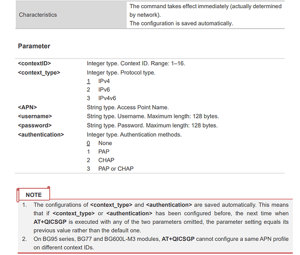

I have the following modem: BG95-M3 - BG95M3LAR02A03_01.009.01.009
And I need to configure the username, password, and authentication method for the APN.
However, the module does not seem to have the AT+QICSGP when I execute the command AT+CLAC, and the AT+CGDCONT does not appear to have any option to insert user, password, etc.
This is due to the firmware version?
Thanks in advance!
This model supports AT+QICSGP and you can configure username and password and authentication with this command.
Thank you for your reply, Mikey!
When I run the AT+CLAC command the AT+QICSGP does not show in the list, and also when I run the command with the parameters for my APN it shows me an error message, is this because of the firmware version?
Best regards,
Hi Mikey!
How can I send you the AT+CLAC command where it shows this option is not visible?
Is there a way for me to reinstall the firmware to guarantee this command is available?
Best Regards,
CLAC should not be supported, I suggest you refer to Quectel’s AT manual
Thank you, herbert!
Now I understood why AT+QICSGP command was “not available” on CLAC.
The modem accepts the command but it is not a supported way to know what commands are truly available.
CLAC generally returns the AT commands described by 3gpp, while QICSGP is a non-standard instruction set encapsulated by Quectel
