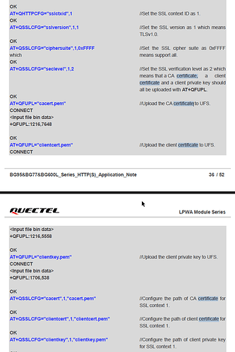

For the record. What would be required for COAP is to setup a DTLS Context with CA-Certificate, Client-Certificate and Client Key, similar as it is possible to configure a SSL-Context for HTTPS (Quectel_BG95_BG77_BG600L_Series_HTTP(S)_Application_Note_V1.1.pdf):
. Im currently not able to successfully perform the handshake with backend side. The reason is currently unknown.
