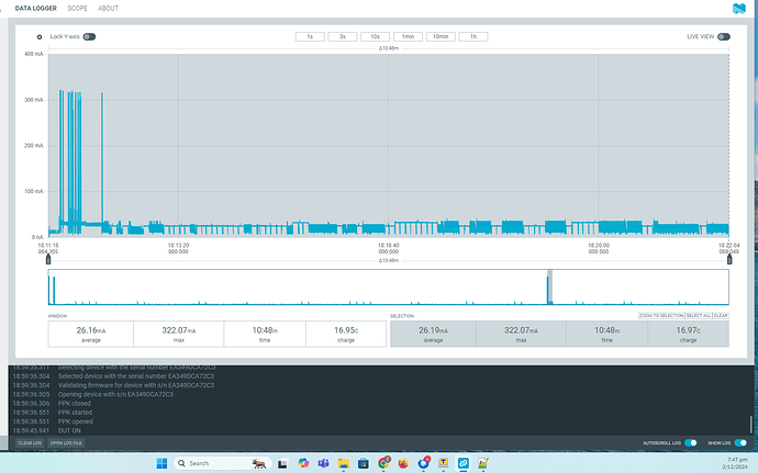

Recently, I’ve start retesting supply current for 1, 4, 8, 12, 18, 24 hours between calls.
All was fine for the 1 - 12 hour times, but 18 hours has an issue which I am still tracking down.
What I have noticed is the current sits at about 25-30 mA for about 13 minutes after the unit should have gone into low power mode. Its not constant, but pluses a mix of slow and fast rhythms. I am guessing its receiving and doing something as there aren’t any 300mA pulses.
Any clues as to what this might be?
