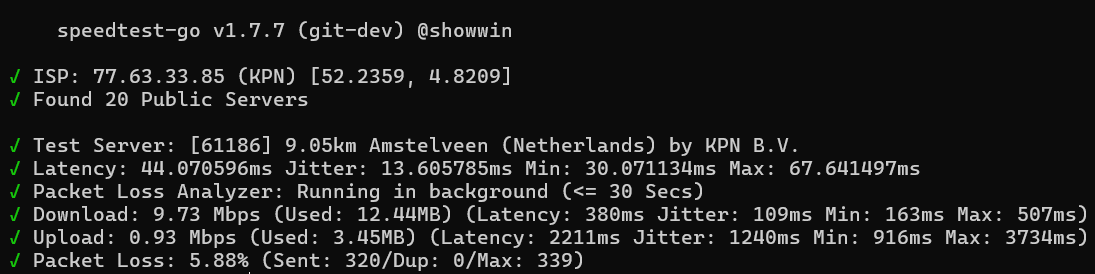

Hi,
i’m using the EC25EUX module on a Linux device which is running OpenWRT.
ModemManager is used for managing the module.
I have very low up and download speeds, only 10mbps download and 0.5 mbps upload.
The EC25 should do 150mbps download speed and 50mbps upload speed.
Changing antenna for more signal does not affect the speed significantly.
What’s the cause of this?
