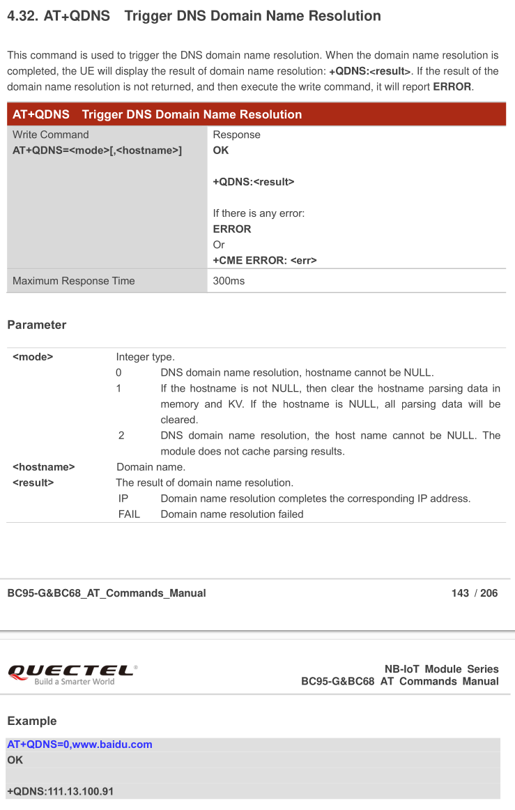

According to BC95-G & BC68 AT Commands Manual V1.5, the timeout for receiving the domain name when executing AT+QDNS is specified as 300 ms.
However, in my case I do not receive any response even after 10 seconds. I therefore retry the command, which results in CME ERROR: 4 (Operation not supported).
