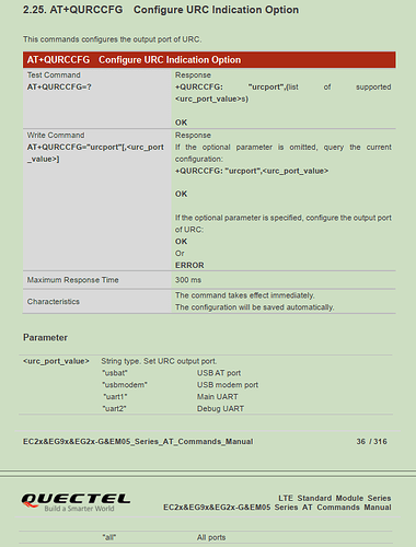

Hi @dy.kim
You can check the following command to see if the URC output port is configured correctly.
