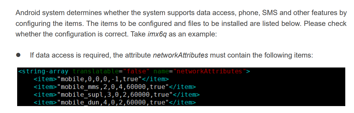

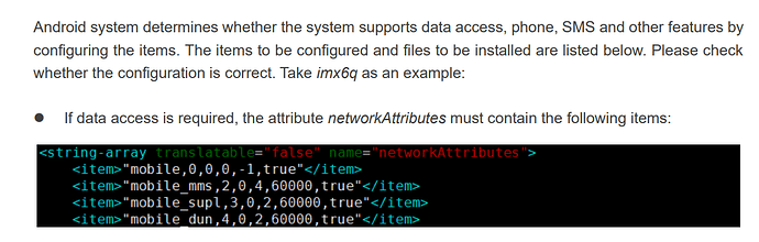

Have you added the networkAttributes?
I have already added the network attributes in my device layer.
Also im not seeing any RILJ logs.
You have any hints about this issue ?

Where did you added the networkAttributes?
From the log, I didn’t find anything helpful.
I have added it in
device/nxp/imx9/ig61m_95/overlay/frameworks/base/core/res/res/values/config.xml
<string-array translatable="false" name="networkAttributes">
<item>"wifi,1,1,1,-1,true"</item>
<item>"bluetooth,7,7,2,-1,true"</item>
<item>"ethernet,9,9,2,-1,true"</item>
+ <item>"mobile,0,0,0,-1,true"</item>
+ <item>"mobile_mms,2,0,2,60000,true"</item>
+ <item>"mobile_supl,3,0,2,60000,true"</item>
+ <item>"mobile_dun,4,0,2,60000,true"</item>
</string-array>

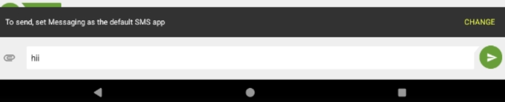

while sending sms im getting below prints on logcat
11-26 15:22:36.892 E/SmsApplication( 1794): com.android.messaging lost android:receive_wap_push: (no permission to fix)
11-26 15:22:36.897 E/SmsApplication( 1794): com.android.messaging lost android:receive_wap_push: (no permission to fix)
11-26 15:22:36.903 W/MessagingApp( 1794): Unsatisfied action condition: isSmsCapable=true, hasPreferredSmsSim=true, isDefaultSmsApp=false
11-26 15:22:37.060 I/MessagingApp( 1794): UI initiated message sending in conversation 1
11-26 15:22:37.068 E/SmsApplication( 1794): com.android.messaging lost android:receive_wap_push: (no permission to fix)
11-26 15:22:37.074 E/SmsApplication( 1794): com.android.messaging lost android:receive_wap_push: (no permission to fix)
11-26 15:22:37.079 W/MessagingApp( 1794): Unsatisfied action condition: isSmsCapable=true, hasPreferredSmsSim=true, isDefaultSmsApp=false
11-26 15:22:37.235 I/MessagingApp( 1794): UI initiated message sending in conversation 1
11-26 15:22:37.244 E/SmsApplication( 1794): com.android.messaging lost android:receive_wap_push: (no permission to fix)
11-26 15:22:37.254 E/SmsApplication( 1794): com.android.messaging lost android:receive_wap_push: (no permission to fix)
11-26 15:22:37.258 W/MessagingApp( 1794): Unsatisfied action condition: isSmsCapable=true, hasPreferredSmsSim=true, isDefaultSmsApp=false
11-26 15:22:37.259 W/WindowOnBackDispatcher( 1794): sendCancelIfRunning: isInProgress=false callback=android.view.ViewRootImpl$$ExternalSyntheticLambda13@bda950
11-26 15:22:37.444 I/MessagingApp( 1794): UI initiated message sending in conversation 1
11-26 15:22:37.456 E/SmsApplication( 1794): com.android.messaging lost android:receive_wap_push: (no permission to fix)
11-26 15:22:37.463 E/SmsApplication( 1794): com.android.messaging lost android:receive_wap_push: (no permission to fix)
11-26 15:22:37.470 W/MessagingApp( 1794): Unsatisfied action condition: isSmsCapable=true, hasPreferredSmsSim=true, isDefaultSmsApp=false
11-26 15:22:37.794 W/WindowOnBackDispatcher( 1794): sendCancelIfRunning: isInProgress=false callback=android.view.ViewRootImpl$$ExternalSyntheticLambda13@83bf4b9
11-26 15:22:43.145 W/WindowOnBackDispatcher( 1794): sendCancelIfRunnin
g: isInProgress=false callback=android.view.ViewRootImpl$$ExternalSyntheticLambda13@7ca65ae
Hii @Bean.Wang-Q
Thank you for your support.
It looks like the issue might be related to the application’s target SDK version.
I tested sending and receiving SMS using the Google Messages application, and it worked properly.
