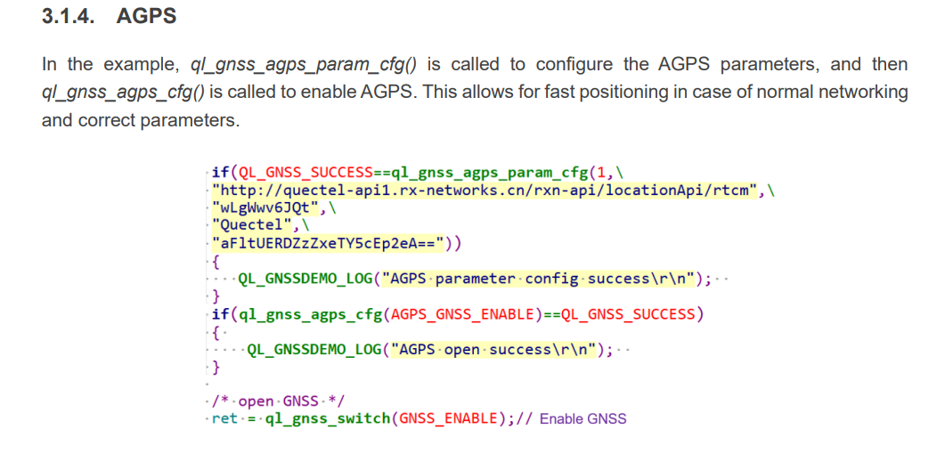

Hi,@murugan
To enable the AGPS function, please refer to the following examples.
