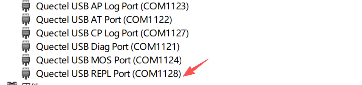

Hi, when I am directly flashing the .bin file, I am not able to see any NMEA port to flash the python scripts
If you flash the V05 firmware, the driver must be updated to the latest official version, and the script communication port must be changed to the REPL port.
